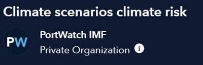

I'd like to hide the 'Private Organization' text from the datasets views. Since the Hub is public, would be nice to hide that since it does not seem necessary and prompt questions from the users

This appears to be a spot for a link to ArcGIS Online organization home pages or galleries. For members of the public to be able to see it, the organization needs to allow anonymous access to the organization:
https://doc.arcgis.com/en/arcgis-online/administer/configure-security.htm#ESRI_SECTION1_323F5BC306A5...
If your organization intends to share content publicly and also list it on a public hub site, I'd recommend they consider setting up a landing page and allowing anonymous access to the organization.
Otherwise if they remain private, this item remains here to explain the absence of a link to their org site. You could create an ArcGIS Idea to have this not show for Hub sites.

I see, I understand now. We would prefer not to allow anonymous access to the organization. I'll post this in ArcGIS Hub Ideas
Thank you for the explanation!
