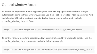

@MattEntinger2 @DanielStoelb @BrianRollison, the disable_window_focus URL parameter has been added to the June release of Experience Builder in ArcGIS Online. Unfortunately, this feature slipped from the documentation update and will be added to the doc site under the Use URL parameters topic and What's new. Meanwhile, you may follow the description below to disable the focus.
Control Window focus
When you want to embed an Experience Builder app with splash windows, page windows, or fixed windows through URL in another web page and do not want it to grad focus automatically, you can use the disable_window_focus parameter to control the behavior. Adding the following URL to the host web page will disable the unexpected jumping behavior. By default, the value is false.
https://experience.arcgis.com/experience/<AppId>/?disable_window_focus=true

Was this ever added to the documentation. I'm not seeing it in the documentation. I just happened to come across this thread, but was able to successfully implement it.
Jianxia
@jbanegas , yes, it is now documented at https://doc.arcgis.com/en/experience-builder/latest/build-apps/url-parameters.htm
