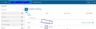

I can see the items when I go to the content library (see image below)

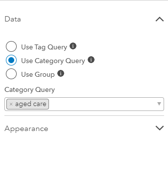

and I have used the category query on the hub site (see below)

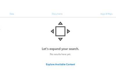

I then save and publish the site. I view the published site and click on the category that I edited and get this saying that there are no results. Even when I reset the filters.
