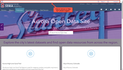

imtigis
Hi Brandon,
I tried to use the html and css code as shared by you but I unable to hide the top bar as did in your site https://missouri-sema-organizational-maps-mosema.hub.arcgis.com/
Kindly suggest how to hide the top bar.
