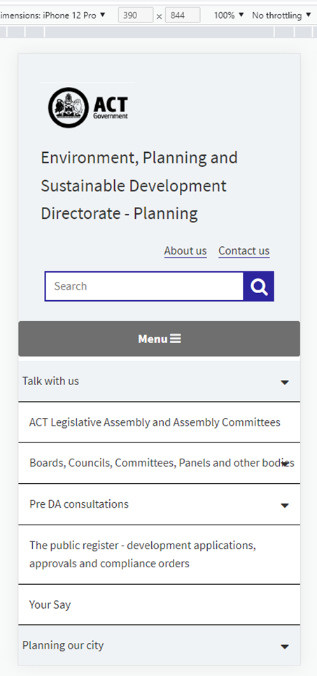

Hi all,
I have been working on a custom site header for an ArcGIS Hub site and have been encountering some issues around formatting a drop-down burger menu option for mobile users. Other posts in this community have been a great starting point for my code (e.g. Hub Site Custom Header), but going for a slightly different look.
What I am trying to achieve is a burger menu button that extends to full screen width, and includes the word "Menu" next to the icon bars (an example is shown below). Instead, the burger menu currently appears as a small button on the right.
Here is the code I am using:
HTML
<nav class="navbar navbar-default visible-xs">
<div class="container-fluid">
<div class="navbar-header" style="color: #fff; background: #313131">
<button class="navbar-toggle collapsed" data-toggle="collapse" data-target="#navbar-collapse">
<b>Menu</b>
<span class="sr-only">Toggle navigation</span>
<span class="icon-bar"></span>
</button>
</div>
<div class="collapse navbar-collapse" id="navbar-collapse">
<ul class="nav navbar-nav">
<li class="cemp-menu-list"><a href="#"><b>Home</b></a></li>
<li class="cemp-menu-list"><a href="#"><b>Ecosystem Summary</b></a></li>
<li class="cemp-menu-list"><a href="#"><b>Approach</b></a></li>
<li class="nav-item dropdown cemp-menu-list">
<a class="dropdown-toggle" data-toggle="dropdown" role="button"><b>Condition Assessment <span class="caret"></span></b></a>
<ul class="dropdown-menu multi-level" role="menu" aria-labelledby="dropdownMenu">
<li><a href="#">Overview</a></li>
<li class="divider" style="color: #313131"></li>
<li><a href="#">Condition assessments</a></li>
<li><a href="#">Recommendations</a></li>
</ul>
</li>
<li class="cemp-menu-list"><a href="#"><b>Data repository</b></a></li>
</ul>
</div>
</div>
</nav>
CSS
.cemp-menu-list {
background: #fff;
border-bottom: 1px solid #c1c1c1;
.navbar-default .navbar-toggle{
background: #313131;
color: #fff !important;
border-color: #313131;
.navbar-default .navbar-toggle .icon-bar {
background-color: #fff;
.navbar-default .navbar-toggle:focus{
background-color: #313131;
.navbar-default .navbar-toggle:hover{
background-color: #6f6f6f;
Any help would be much appreciated. Thanks!
