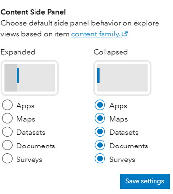

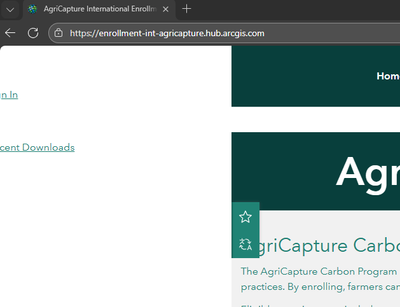

I’m working on a new ArcGIS Hub site and am running into an issue with the Content Side Panel on newly created Hub sites after the most recent updates.
The problem I’m seeing is that the Content Side Panel does not collapse properly. It displays partially off-screen, and even when the collapse settings are enabled, the panel remains visible and cannot be collapsed.
What I’m seeing:
  • The Content Side Panel extends off the screen on initial load
  • Collapse settings are turned on, but the panel still displays
  • There’s no way to collapse the panel unless I zoom out to less than 100%
I’ve included screenshots below showing:
  • The Content Side Panel settings
  • The default view when opening the Hub site (with the panel off-screen)
Settings for Content Side Panel:
Deafult View when I open the HUB site.  Note that the panel is showing off the display and there is no way to collapse it, unless I zoom out to <100%:

JustinPrather
Hi @MeganEngel2
It looks like you have added custom CSS that is targeting the <body> of the site ... which is bringing this side panel partially into view.
The declaration of `display: flex;` is the ultimate culprit, I believe.
JustinPrather
Hi @MeganEngel2
MeganEngel2
Thank you so much! That was exactly the issue!
