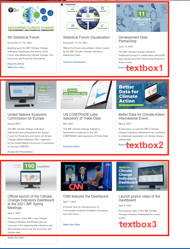

Question 1: We have an events and media page where each event is assigned a custom designed card. Currently, we display 3 cards per row (a text box) as shown below. Unfortunately, that becomes a problem when we need to add a new card, because each card needs to be shifted by one, with some moving from one text box to the next. Is there a way to instead have one single text box with all the cards, and use CSS to dynamically force this 3 columns display on large screens and 1 column display on mobile?
Question 2: Is it possible to extend the height of the cards to be the same? Ideally this should happen to cards that belong to the same row, otherwise even simply adjust all to the largest height without the need to hard-code this value in advance.
The page for reference: https://climatedata.imf.org/pages/events-and-media
