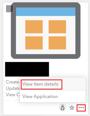

1. In ArcGIS Online, navigate to Content > My Organization. You could further filter the items by Item Type (Apps > Sites)
2. If you could locate the Hub Site among the listed items, click on the three dots (...) and choose "View Item Details".
3. In the Item Details Page, click on Settings. Under "Delete Protection", Uncheck "Prevent this item from being accidentally deleted.". Click Save. Then Click "Delete Item".

Thank you for your suggestion. I can follow the steps you outlined to get to the 'Delete' button.  I must say, however, that i hesitate to do that when i see the Item Description as this:
DO NOT DELETE OR MODIFY THIS ITEM. This item is managed by the ArcGIS Hub application. To make changes to this site, please visit https://hub.arcgis.com/admin/
Should i care about this warning? Since i can't access the site via the Hub admin, is this approach the only way to delete the site?
Thanks again.

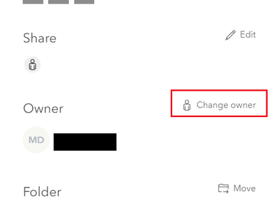

In the Item Details Page of the corresponding Hub Site Application > Overview, scroll down and change the owner of the item to your AGOL ID.
Check again in your organization's Hub Site (Admin), if the item is reflected, and delete it from there.

I tried to re-assigning ownership to my account but that change had no impact on the sites visibility. So, i took the route outlined by you. I now have two less (orphaned) Hub sites hanging around.
