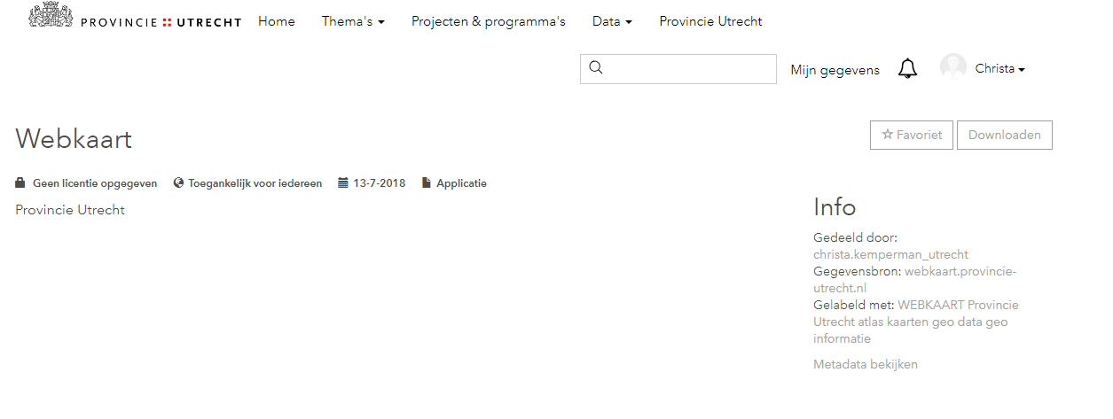

The item I add in my arcgis online content will be an application, which refers to the app (or in some cases a different viewer) I want to show. The item is shared globally, the app it refers to with the only the neccesary group. The item was then added to the gallery card in Hub. That worked perfectly before, but now I get some sort of metadata-page after opening my item, without any acces to my url (like the page below).
This is very troublesome for us, because we are kind of fond of the items-option. Could you please fix this a.s.a.p?
Please check our hub for more detail: https://geo-point.provincie-utrecht.nl/ . If you open this page: https://geo-point.provincie-utrecht.nl/pages/bestuurlijke-zaken you'll find a Webkaart-button in the gallery which will show the problem. It occurs all over our site but I have find a workaround for the main pages, so people can again work with it.

At any time you can turn off the app page capability.  Keep in mind if the URL you are pointing to in your Application is HTTP when your site is HTTPS, then the Application will be blocked from loading sending you to an `/items` route.
I noticed this might be the culprit with the "Interbestuurlijk Toezicht (IBT)" app on the gallery on Geo-Point Utrecht, the item seems to be an HTTP URL (http://utrecht.maps.arcgis.com/apps/MapSeries/index.html?appid=ff32bbd4045e4930b028a3bf145e9a38 ).
I see what you mean about the "Webkaart" app, very odd -- we are looking into a fix right now.  Thanks for raising it to our attention!
