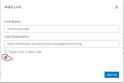

I am inviting users to our Supporting Teams via ArcGIS Hub. During the invite process, there is a step to customise the invite notification. In the Body of the message, it is possible to add hyperlinks.
However, if I add a link using this tool, the whole notification window crashes/disappears and I have to start the process of selecting users to invite all over again. The link destinations I am trying to use have all been added in the Hub Advanced Settings (see this article).
I notice there is also a check box in the Add Link window which has no text next to it. I've no idea what it is for.
