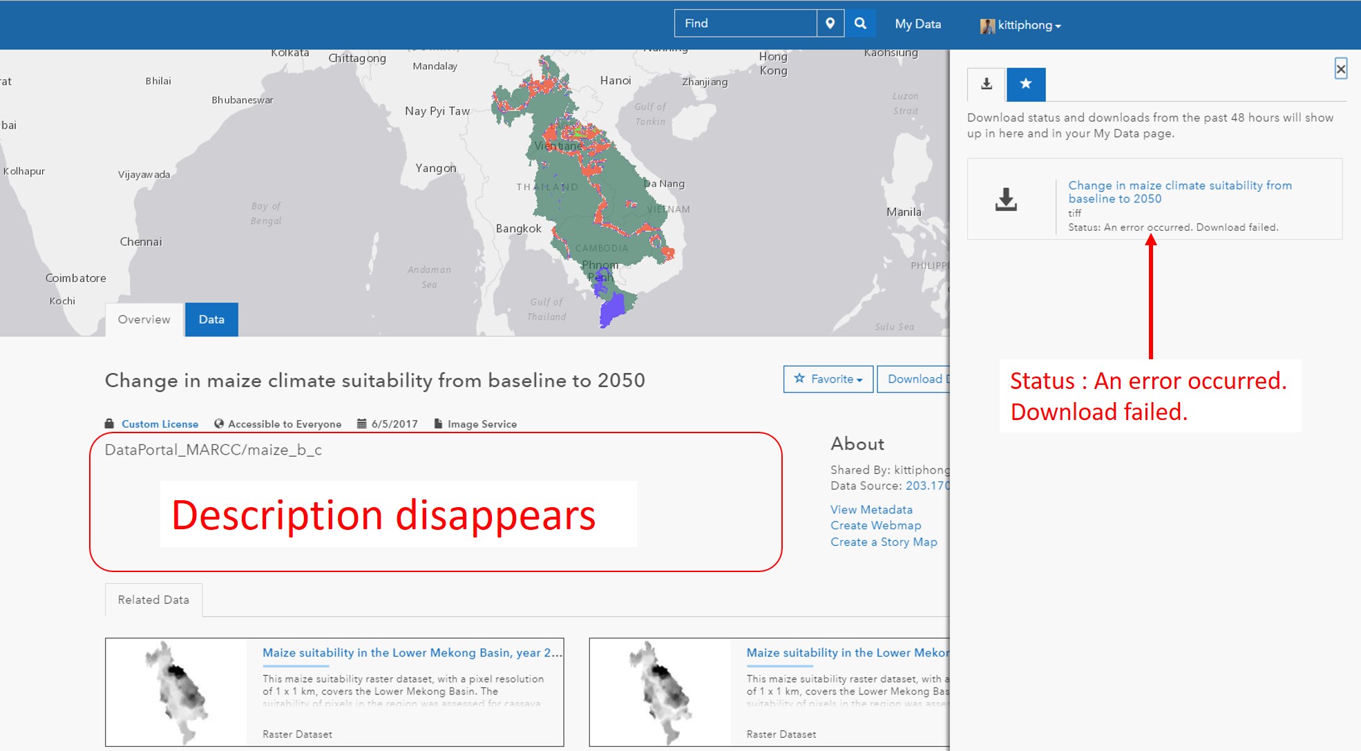

Hi,
My name is Kittiphong Phongsapan. I’m working on the ESRI open data portal and got stuck with some issue about the portal itself.
After I upgrade the current version (ArcGIS Open Data 1.10) to the new version (ArcGIS Open Data 2.0) the dataset cannot be downloaded and the description of the dataset are disappear. The issue is depicted below:
I’m sharing the site of both versions for your reference
Version 1.10
http://index-servirmekong.opendata.arcgis.com/datasets?sort_by=relevance
Version 2.0 (which having the issue)
https://data-servirmekong.opendata.arcgis.com/datasets
It would be great if you could help me to address the issue that I have list above.
Thank you.
Kittiphong
DanielFenton1
I checked this dataset and it looks like the description is appearing correctly. The reason that downloads are failing is that the server has SSL improperly configured. I would recommend working with Esri Support to set of the Web Adaptor with SSL certificates properly configured.
