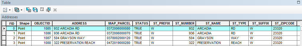

We had a user contact our organization about a strange data issue.
The user downloaded our address points (Dataset | City of Chesapeake, VA Open Data Site) and noticed we had an abnormally high number of addresses that have a street prefix
"ST_PREFIX" in ( 'E', 'N', 'S', 'W')
, just about every record.
I checked our enterprise geodatabase and the data does not match (Query: address_points (ID: 😎 ).
Given what happened, I reset the downloads and updated the index on the site.
Even with the resets, it seems like Open Data shows the correct data, but when you download the shapefile, there's data being added to both the ST_PREFIX and ST_SUFFIX field.  There is also a domain on both fields if that makes a difference.
Just reporting this strange occurrance.

Cameron, you are indeed correct that this is due to theCoded Value Domains.
I’ve noticed that your CVDs codes are not different from the actual values. A workaround, while we work on a bug fix would be to remove those domains.
I’ll keep you updated about a fix for the underlying cause. Sorry about the issues.
Daniel
DanielFenton1
Another potential workaround is to use Null instead of “ “ for the values in those fields that are empty. That’s what’s tripping up our logic.

Yes, we recently made a fix so that Coded Value Domains would work properly in downloads. Unfortunately that fix has revealed an edge case that we did not test for.

We've deployed the fix to production. I downloaded the dataset and am no longer seeing the issue with incorrect prefixes or suffixes. Please take a look at the data and let me know if everything looks good.
Thanks,
Daniel
CameronMcCormick
Awesome!
We are good to go
