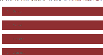

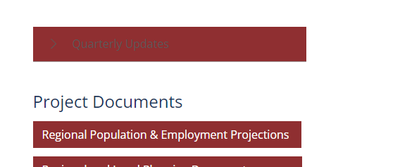

I had an accordion item custom coded to have white text, but today out of nowhere the text turned grey. It isn't only the accordion items that this happened to - there are several other elements where the text is displaying gray rather than white and I'm not sure what could have caused it. Has anyone run into a similar issue?

Hi @RohitSharma-1 - the URL is here: https://westtnplanning.tn.gov/
It seems to be happening anywhere we have accordion items:
1. On the Project Information page (https://westtnplanning.tn.gov/pages/project-info😞
2. Planning documents page (https://westtnplanning.tn.gov/pages/planning-documents😞
There are other places this is happening, but here is the basic CSS we've been relying on the preserve the accordion formatting in #2. I don't see anything that has changed in the code:
