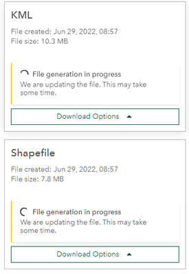

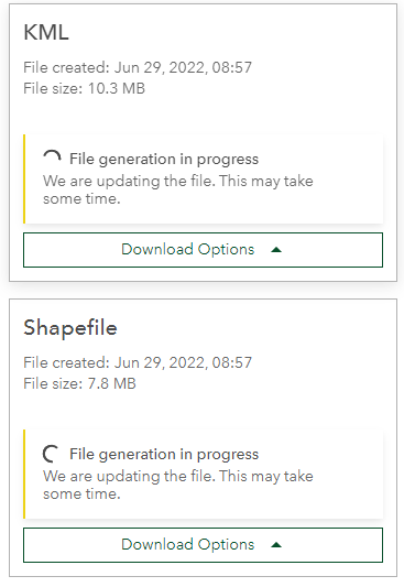

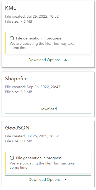

Hi,
We have received reports from end users that some isolated dataset downloads are hanging in some formats on our ArcGIS Hub site (running for >18 hours).  I have replicated this issue locally.  Please investigate.  We have cleared the browser cache and refreshed the content catalogue with no effect.  Is this a widespread known issue or isolated to our ArcGIS Hub site only?  Please note, not all updated overwritten layers have been affected in this month's update cycle.
Home page: https://naturalengland-defra.opendata.arcgis.com
Screenshots below are in the Chrome browser.
See examples below - there may be more?
1. Dataset page: https://naturalengland-defra.opendata.arcgis.com/datasets/Defra::ancient-woodland-england/about
2. Dataset page: https://naturalengland-defra.opendata.arcgis.com/datasets/Defra::national-nature-reserves-england/ab...
3. Dataset page: https://naturalengland-defra.opendata.arcgis.com/datasets/Defra::england-coast-path-route/about
4. Dataset page: https://naturalengland-defra.opendata.arcgis.com/datasets/Defra::england-coast-path-coastal-margin/a...
