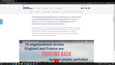

Unfortunately, I still get a double scrolling bar. I think that's because I've now added a footer to my site, as the extra scrolling bar now appears when I'm using the app URL or embedding the app on a page:

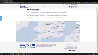

This means that when I scroll to the end of the StoryMap, it jumps up and down a bit and gets 'stuck' before it switches to the other scroll bar and shows the footer. When I then scroll up again on the StoryMap, the footer stays at the bottom of the screen and the navigation bar of the StoryMap disappears:
