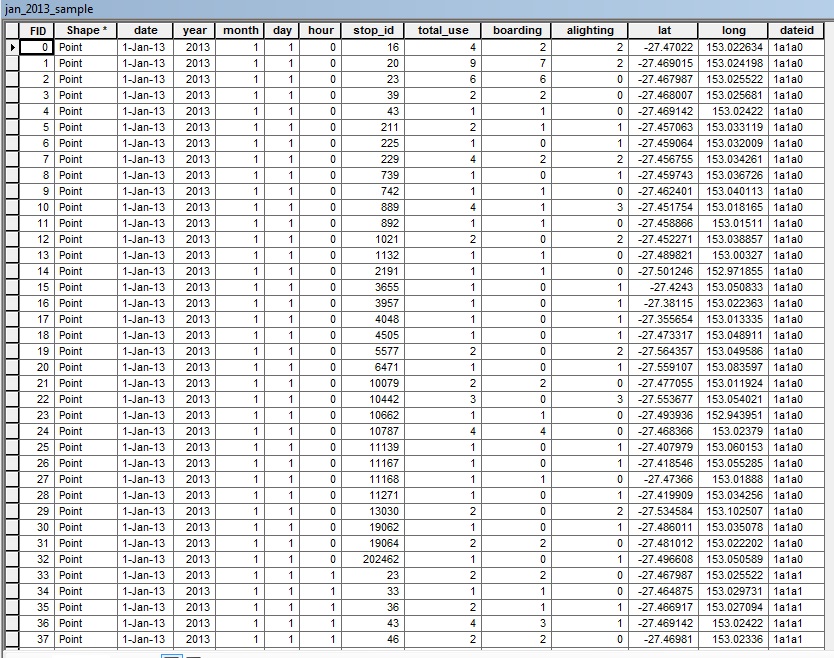

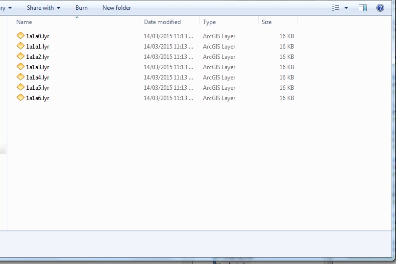

Hello everyone,
I'm trying to write a python script to loop through geostatistical layers in a folder (a snapshot is attached below), then loop through another folder which contains a  point shapefile (a snapshot attached as well), find the match between the two  based on names (e.g., 1a1a0.lyr vs 1a1a0 in the 'dateid' field), and last, use a 'GA layer to point' to the matching points. So how can I accomplish this task? More specifically, how do I create a nested loop to match the layers with the points of one shapefile?
Many thanks,
Sui
These are a sample of layers
This is the attribute table of points
