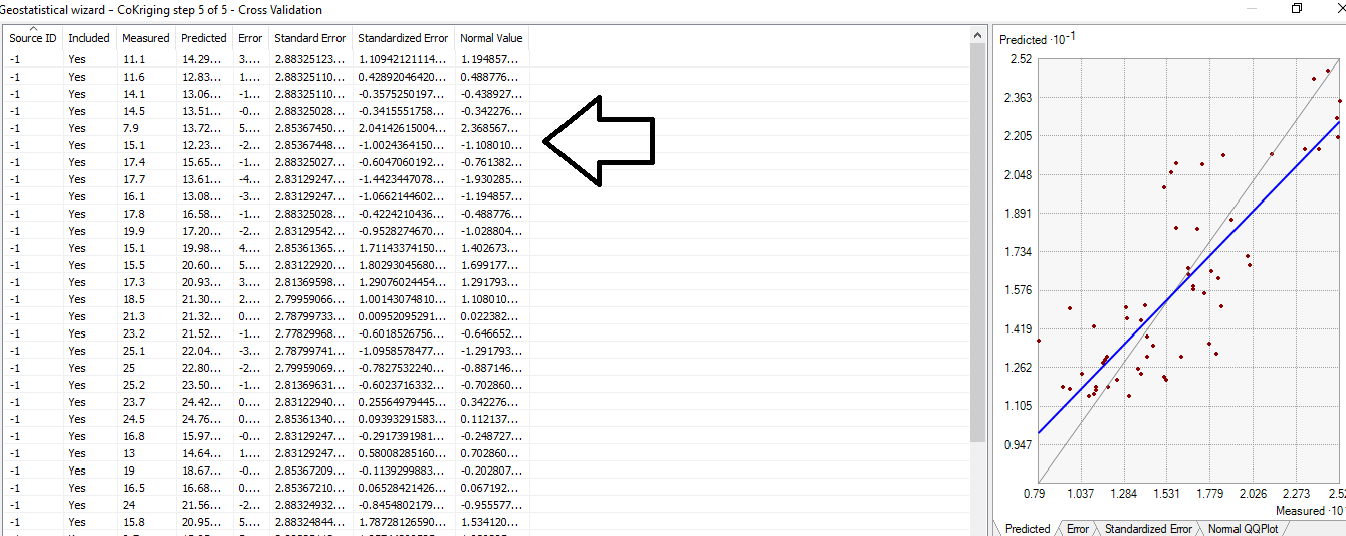

Hi, Is there a way to export excel file for the cross validation process (indicated below in the image) only. Export option that is available at the bottom exports the interpolated values at the unsampled locations. However, I only need measured and predicted values at the sampled locations in order to calculate coefficient of determination (r2) for the kriged map.

Thanks for the reply. I am interested to export the table indicated in the image above. However, "Export result table" option available at the bottom of the crossvalidation window in geostatistical wizard creates result table for sampled and unsampled locations. However, I only need results for sampled points.
Any help in this regard would be appreciated.

We have sampled 82 datapoints. However, "export result table" option generates file for 30,000 interpolated values. I only need predicted and measured values for the sampled dataset to calculate R2. How do I get that file?

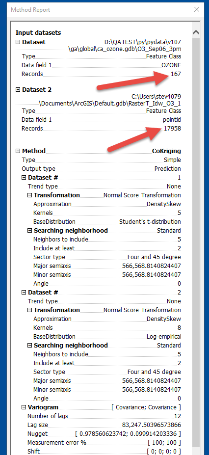

 Please also include a screenshot of the "Method Report", i.e. the last dialog that appears before the Wizard closes.

 Please also include a screenshot of the "Method Report", i.e. the last dialog that appears before the Wizard closes, viz.,
