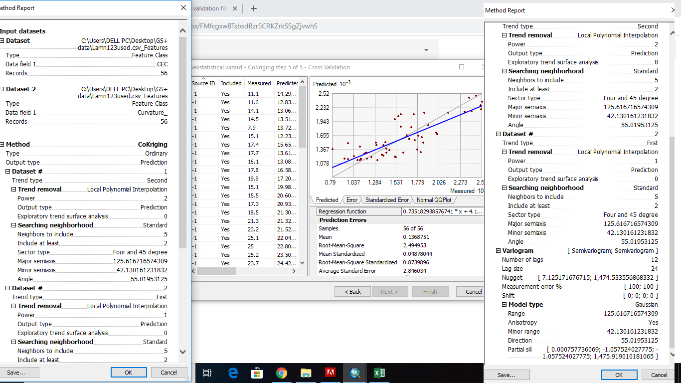

Hi, Is there a way to export excel file for the cross validation process (indicated below in the image) only. Export option that is available at the bottom exports the interpolated values at the unsampled locations. However, I only need measured and predicted values at the sampled locations in order to calculate coefficient of determination (r2) for the kriged map.

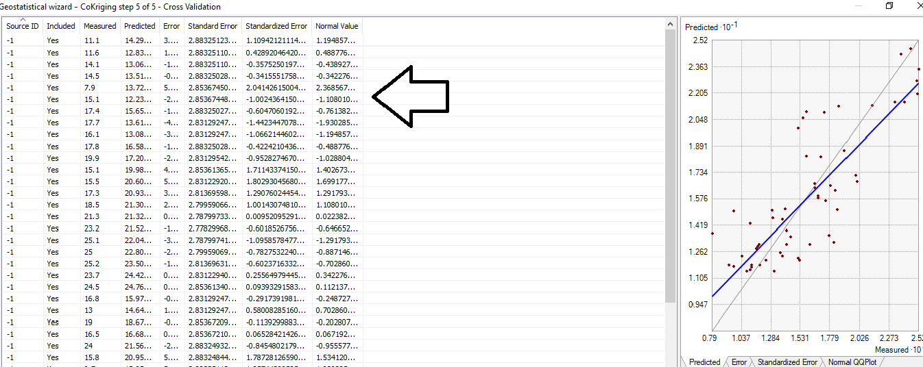

Attached is the screenshot of dataset from my 2nd site. It's the same as my 1st site, with exception of 56 sampled data points instead of 82. Number of terrain covariates is around 156000. However, I just notice that the number of records for both datasets is showing up as 56. So, maybe combining the two datasets is causing the issue.

The number of points that come out of the Export Result button should be equal to the number of rows in the cross validation table in the Geostatistical Wizard.  I don't know any reason they would be different.  I can also see in your table that all Source ID values are -1, which is also strange.

Regardless, you should try clicking Finish then OK in the wizard to create a geostatistical layer in your map.  Then use the Cross Validation geoprocessing tool with the layer.  The optional feature class output from the tool produces the same feature class as the Export button in the Wizard.  Using the geoprocessing tool instead of the Export button may give what you are expecting.
