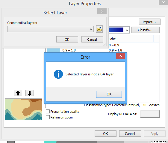

  1. open the Layer Properties to the same tab as shown in the image above
  2. click the Import button.
  3. browse to the layer file you saved previously

Ok but I get this when I try to import it.
