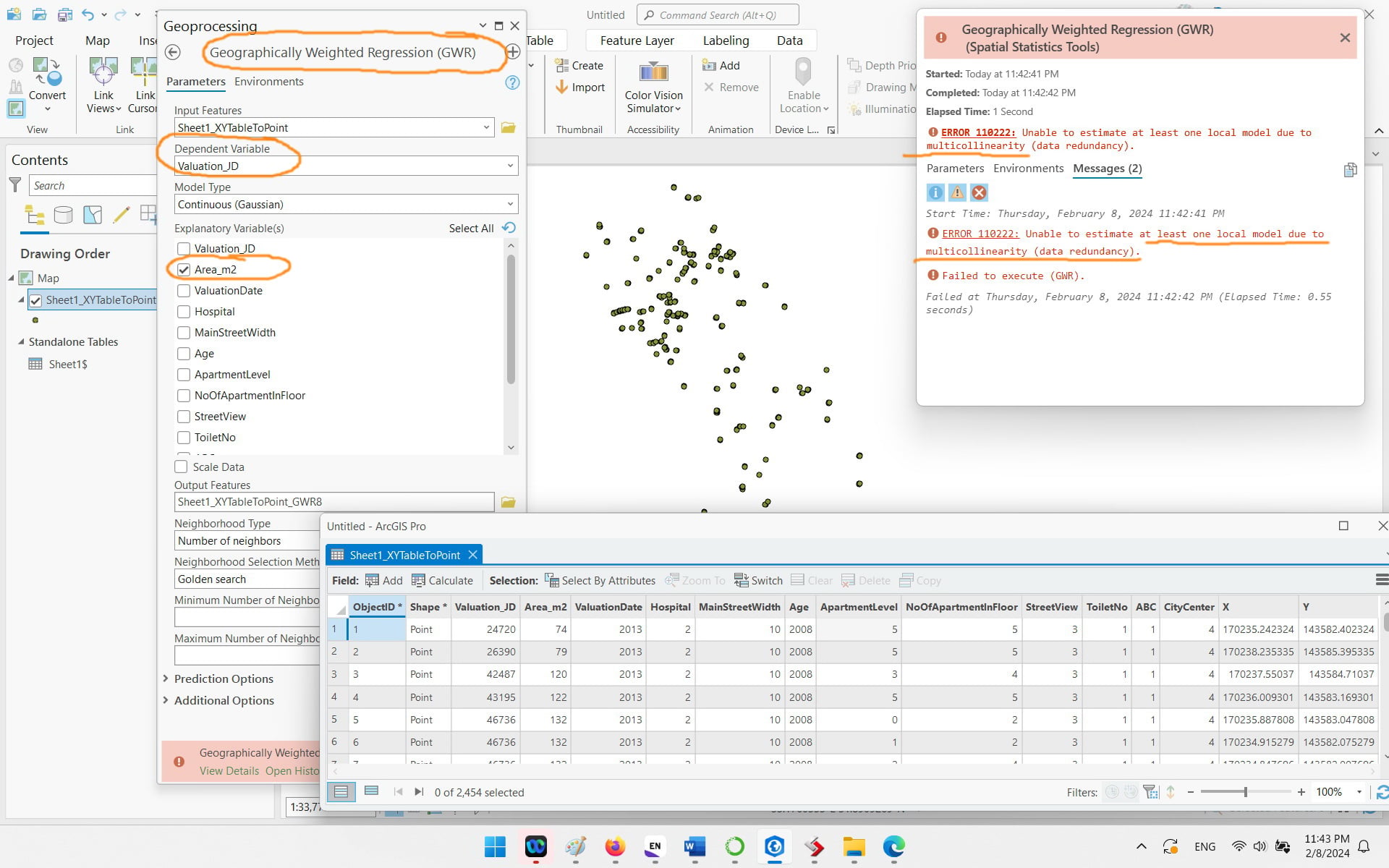

I couldn’t figure out how the multicollinearity can be an issue when using the GWR with only one explanatory variable.
What could be the issue here?

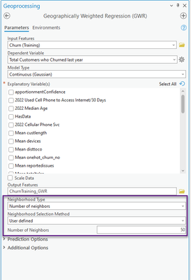

1. Increase the starting neighborhood size. Larger neighborhoods often have a better chance of including variation needed for those local models. To increase the starting neighborhood size, set the Neighborhood Selection Method to "User defined" and test with various increasing sizes.

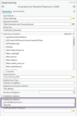

2. Use the Gaussian Kernel. The Gaussian Kernel essentially makes all features neighbors of all features, increasing the neighborhood size but diminishing the effect of distant neighbors. This may help, as the model essentially uses all the data and allows the full variation in your variable to be used in the local model.

Thank you, Erci and Alberto, for the very useful input. It works fine with the settings indicated in the screenshot below, as per the guidance from Alberto.
