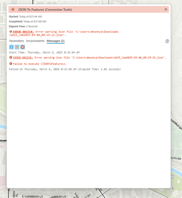

I have configured an ArcGIS GeoEvent Service to write out JSON files for the jams and alerts.
I tried to create a feature class from each of the file types, jam and alert but it errored in ArcGIS Pro.
How can create a feature layer to output the WAZE data to?

What exactly errored? Share some screenshots of your geoevent service and definitions, as well as your outputs.
MeleKoneya1
I was trying to create a feature class in Pro from the flat WAZE Json but it errors out without much info.
My thought was if I could create a Feature Class I could publish it and use the add a feature output
Gene_Sipes
What format is your JSON in? Because the JSON to Features tool accepts JSON but it has to contain feature collections. In other words, it has to be formatted like geoJSON.
MeleKoneya1
Let me see.     I had Json and am now trying to create GeoJson in GeoEvent Server.   Hopefully, that will do the trick
MeleKoneya1
Getting the data into the proper format, GeoJson, was the key.    Thank you for the help
