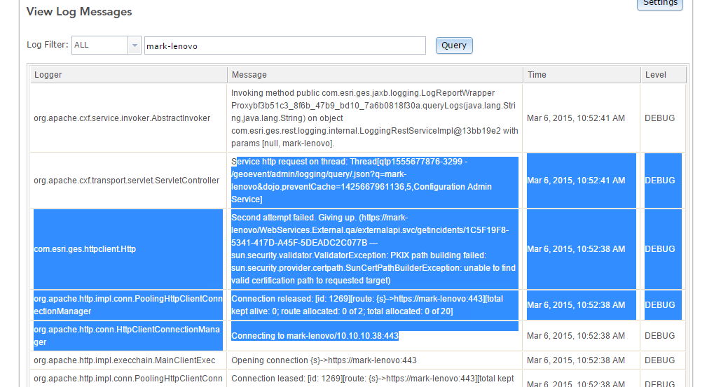

This the error displayed in my Geoevent error log:
Is there a special certificate authorization list for the JRE that geoevent uses? Does it use the windows certificate store at all? Is SSL event supported on the JSON input?

Hi Mark,
GeoEvent uses ArcGIS Server's JRE, so I'd think you'd want to add the cert to Server's cacerts located at: C:\Program Files\ArcGIS\Server\framework\runtime\jre\lib\security.
Have you tried that?

MarkCollins
Mark,
Thanks! This was very helpful in pointing me in the right direction. I've tested it using the jre in this path and it seems to work fine. Here are the complete steps for importing a certificate into the cert store.
  1. Save a copy of the Certificate Authority ssl certificate to the < C:\Program Files\ArcGIS\Server\framework\runtime\jre\lib\security>.  This can be done by accessing one of your web pages via https in a browser and looking at the certificate information. Go to the details tab and click Copy to File. Export it to a DER encoded binary x.509 (.CER).
  2. Run the following command, including the double quotes, in the < C:\Program Files\ArcGIS\Server\framework\runtime\jre\lib\security> folder to import the Certificate Authority certificate to the cacerts file (in this example, the certificate is called esrica.cer):
    “C:\Program Files\ArcGIS\Server\framework\runtime\jre\bin\keytool” -import -trustcacerts -file esrica.cer> -alias esri_ca -keystore cacerts
    The password for this cacerts file is 'changeit'.  The alias parameter in the command can be anything and must be different for each certificate added to the store.
  3. Restart the GeoEvent processor service for the changes to take effect
