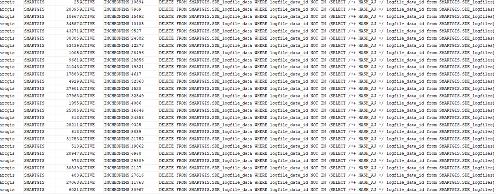

When the user starts servers, the SQL statements appear repeatedly (Please refer below).
DELETE FROM SMARTGIS.SDE_logfile_data WHERE logfile_data_id NOT ON (SELECT /* + HASH_AJ */ logfile_data_id from SMARTGIS.SDE_logfiles)

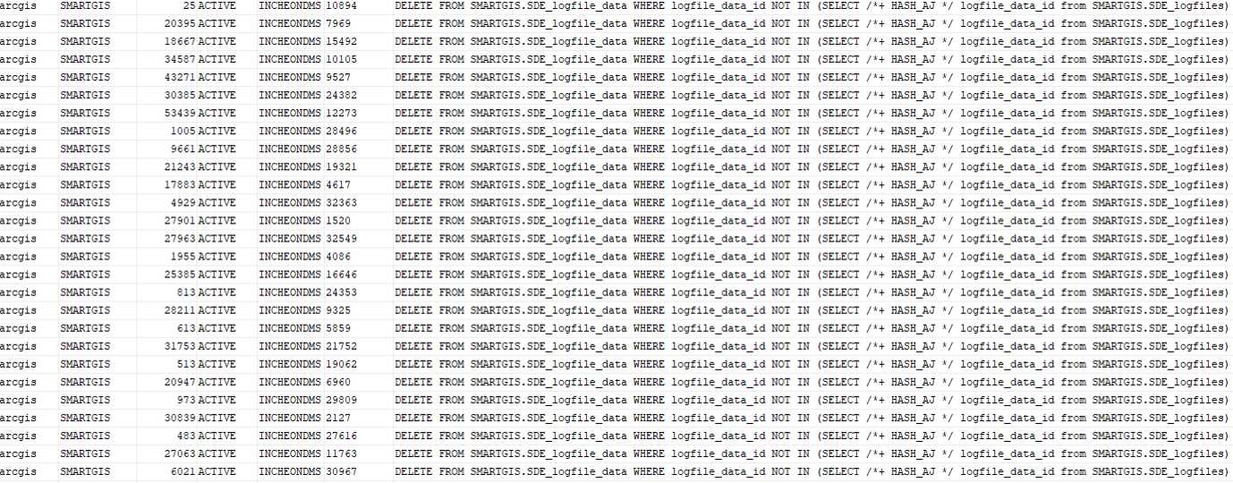

I figured the message below appears when the oracle hits the max utilization.

The problem was solved by stopping all the services on the ArcGIS Server and stopping GeoEvent Server. After starting a service one by one, the SQL statements does not appear.
