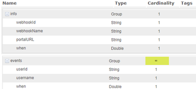

I might suggest allowing GeoEvent to create a new definition automatically. This should then show this object with an infinity icon instead of the number one.
It is possible your existing output layer will require modification as well. You might then experiment with using this handy processor to break the array: Field Splitter Processors for GeoEvent Server
