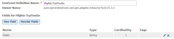

For my test, I configured a tcp-text-in input:
  • To create a GeoEvent Definition based on delimited data it receives
  • Specifying an Attribute Separator as either \t or \u0009
… the event definition created by the input had only one event field, suggesting the attribute separator was not recognized

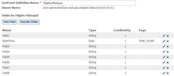

However, if I configure a file-csv-in input with similar specifications .. the event definition created has the expected fields:
