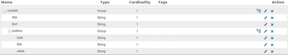

Referencing the JSON in my original post - I create a Definition, starting with the JSON Object Name (I am interpreting "content" as the Object Name):

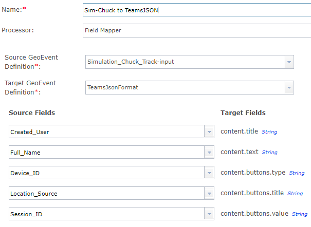

I have an test CSV file and input created with a number of String fields - so I throw that into a Service with a Field Mapper Processor:

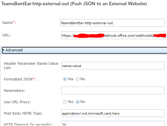

At this point, I create the output...

The Field Mapper processor was designed to flatten a schema to make the event record's data structure compatible with the ArcGIS REST Services API used when sending processed event data as JSON to a feature service's addFeatures or updateFeatures endpoint.
You cannot use Field Mapper ... or any of the out-of-the-box processors ... to write data to a hierarchical structure. It appears, from your illustration, that event data being ingested is already adapted using flattened data structure (e.g. the cardinality of every event record attribute is '1' and the data type is DateDoubleLongString, (etc.) ... not Group).
I think you'll want to consider developing a custom outbound adapter which is able to take a flat data structure and adapt it into a hierarchical data structure expected by the Web Hook you want to receive data you've processed through a GeoEvent Service.
