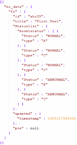

The first remark I have is that XML is translated to JSON by the product’s adapter.  So you will want to avoid using XML attributes which can contend with sub-elements of a given node. Your data sample is pretty clean, but to illustrate, this is what it looks like as JSON:
Your challenge, using GeoEvent, will be that you want to access items in a list which is part of a larger structure. If you were to stipulate that the list <Assetstatus> would always have exactly 5 items, then we could assume that you could pull specific items out by index. For example:
ez_data.fz.Statuslist.Assetstatus[3].Status
