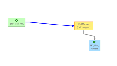

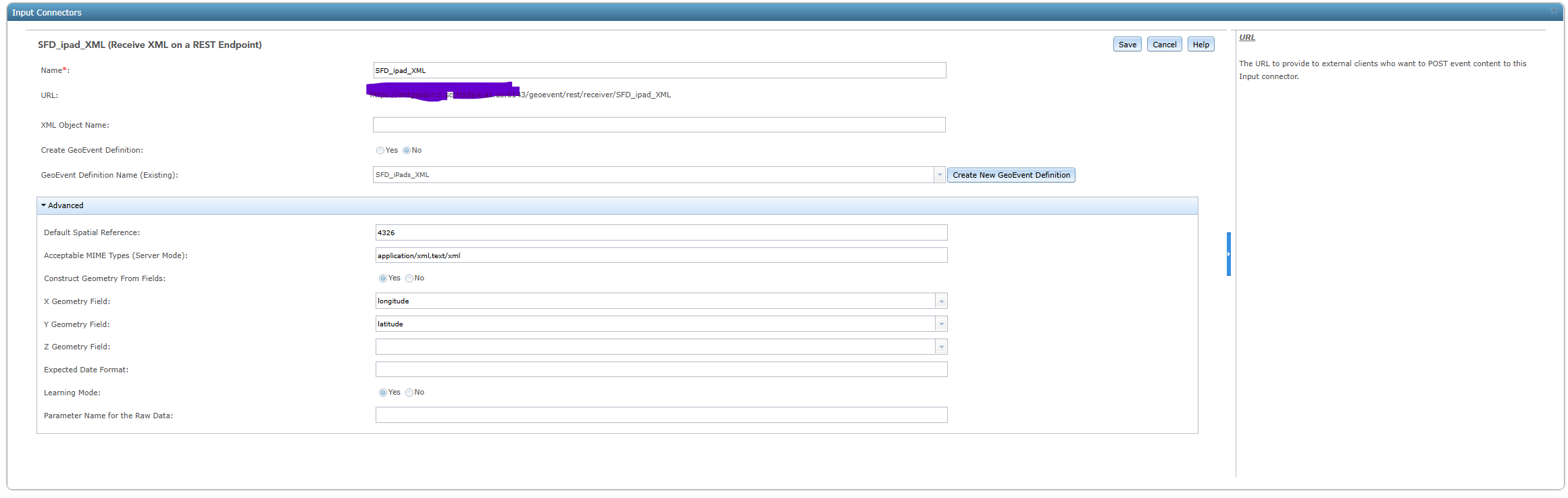

I have crated an Receive XML on a REST Endpoint connector and am trying to get an XML file to process in the service below
I sending an XML via Python to see if anything comes through but have not seen it working as there is nothing in in/out and sample route shows nothing.

At least two things look suspicious in your XML Data block -
There are two << opening brackets instead of one.  Shouldn't it be <location data>
Also, you enclosed the Lat & lon data in Square Brackets, which is not standard XML..
Check your Logs, and maybe add a temporary output to a text file, that you can then open and see if your XML document made it all the way in.
MeleKoneya
@JeffSilberberg   Thank you for seeing my poor formatting.   I think you are on to something for sure as know I can see the file getting passed through the connector.    I think I still need to fix a few things and will try the suggestion of written it to a text file to see if I am missing something else in the format.   Thanks again!
