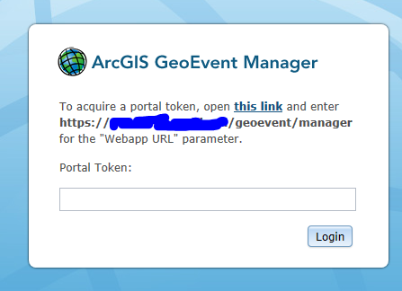

When I try to login to GeoEvent Manager I am always prompted with a window saying "To acquire a portal token, open this link and enter <geoevent manager url> for the "Webapp URL" parameter."
Although I can log in with the token why is this necessary?  Why isn't this single-sign on as with AGS?
I'm using 10.3.1 GeoEvent, AGS, and Portal.  AGS is federated with Portal and Portal is using Windows AD logins.
Related to this issue (I think) is that any Stream Services I create can only be viewed if shared with "Everyone" in Portal, even though I've created the service with my Windows user, and in Portal it shows the stream service under "My Content".
Thanks!

For the 10.3.1 release we tried incorporating a library to improve the user's sign-in experience but discovered a rather severe security vulnerability and had to revert (remove) the code changes. We improved single-sign-on experience for the 10.4 product release.
To provide you a little bit of background, GeoEvent requires anonymous access to two different REST endpoints in order to coordinate authentication with Portal when Portal has been federated with ArcGIS Server and authentication is passing through the web-tier (e.g. Basic Authentication or IWA).
At 10.3 / 10.3.1 ... if GeoEvent cannot access these endpoints its failover behavior is to prompt the user to acquire and provide a token in order to log-in to the GeoEvent Manager.
I think the 10.4 / 10.4.1 login experience, when federated with Portal, will be more in-line with what you expect.  There is one known issue that is currently deferred to 10.5 -- after federating with Portal and completing the configuration of your SSL certificates you often have to restart the GeoEvent Windows service twice (2x) in order to get it to recognize the new security topology.
