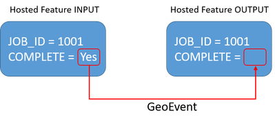

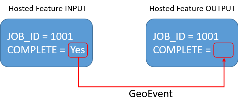

Hi All,
Don't have much experience with GeoEvent... I am trying to update a single field in one hosted feature with a field from another hosted feature using GeoEvent. The Input type is 'Poll an ArcGIS Server for Features' and the Output type is 'Update a Feature'. Both the input and output count go up when a record meets the filter on the input (Complete = 'Yes'), though the value is not written to my output feature. Both hosted features have a 'Job ID' field, and I have set the TRACK_ID to these features for the Input and Output Definitions – not sure if this is correct. I have used the Field Mapper to map the 'Complete' field from the Source to the 'Complete' field of the Target. This is the only value I am after.
 I'm sure it is something simple I am missing or have not setting up correctly. Do I need to add a filter for Job_ID = Job_ID so the right Output feature gets updated? I have assumed TRACK_ID manages this. I'm hoping someone can point me in the right direction or share an example? Thanks.
Jamie.

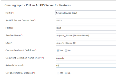

Try with the attached datasets.  Publish each as editable feature services (i.e. Airports_Source, Airports_Target).  In the below example, I published the services as hosted ArcGIS Server services.  Here is how I set up GeoEvent:
1.  Create a Poll an ArcGIS Server For Features input for the Airports_Source feature service

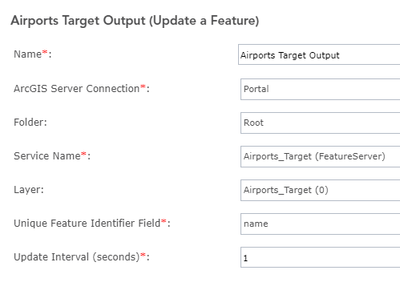

2.  Create a Update a Feature output for the Airports_Target using name field as the Unique Feature Identifier Field:

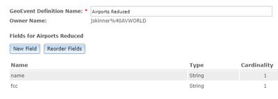

3.  Create a new GeoEvent Definition with only the name and fcc fields:

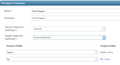

4.  Create a GeoEvent Service.  Add a Field Mapper Processer between the input and output:

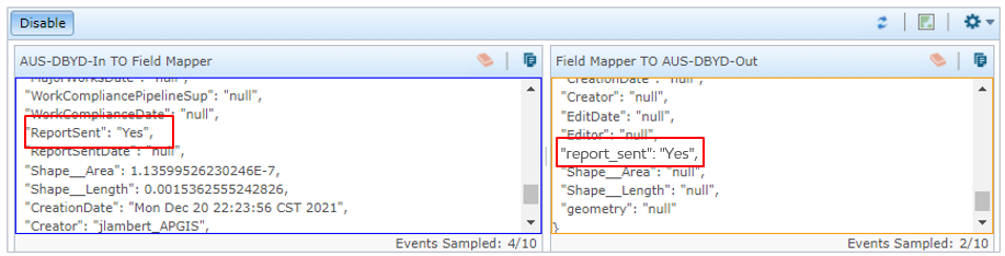

I think I have captured everything in the image below:
The 'ReportSent' value is being mapped, though it seems like the corresponding 'sequence_id' record in the Output hosted feature is not being picked up / written to. The Output feature is editable. Do I need to add a Filter or some other process? Thanks.
