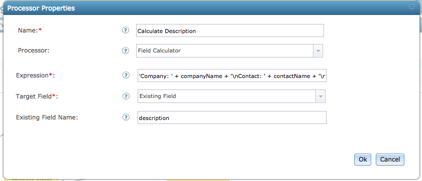

I am attempting to have a new line be created using a field calculator by just using \n in the expression.  However doing this results in \\n being stored after the calculation.  Any suggestions on how to get around this, is there a proper way to escape backslashes?
expression used in field calculator processor
resulting JSON in feature layer

I actually just answered it myself by using <br> instead of \n.  Thanks for the other answer.
