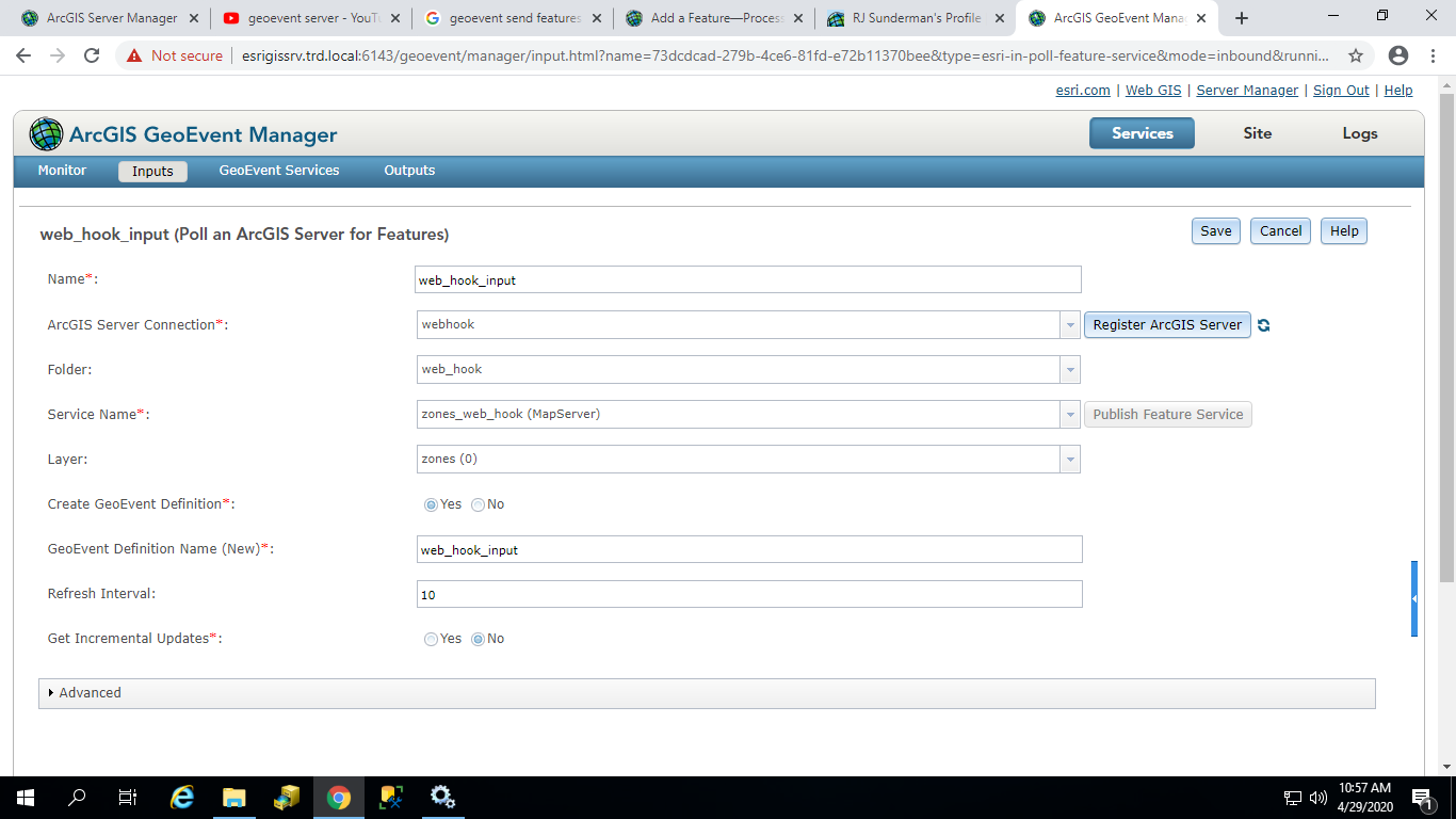

the in put connector ( Poll an ArcGIS Server for Features)
the out put connector (Push JSON to an External Website) not using any filter or process.
This is in put . in put connectors

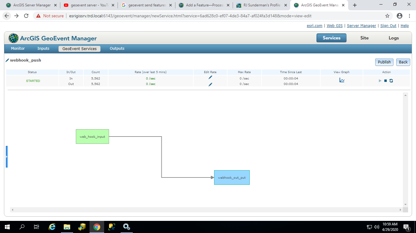

Geoevent Services

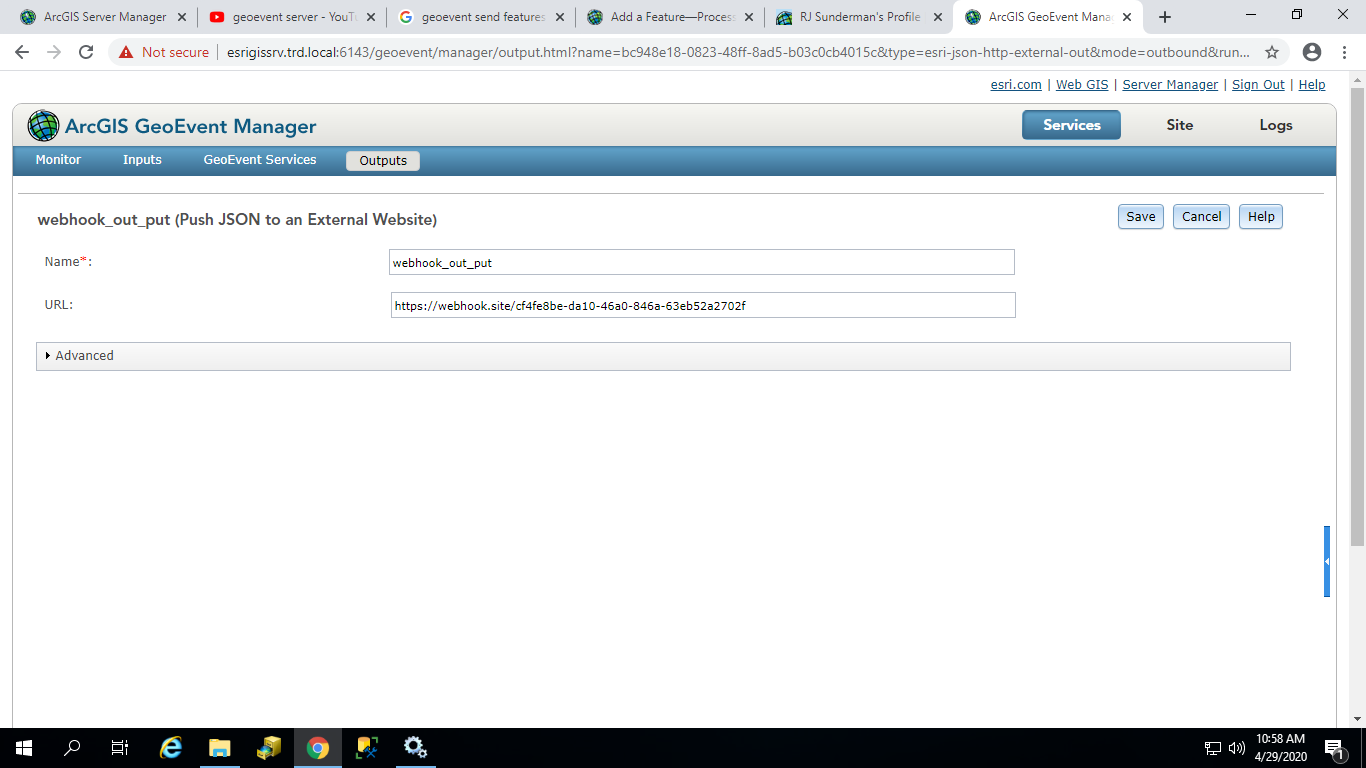

out put connectors
out put connectors
