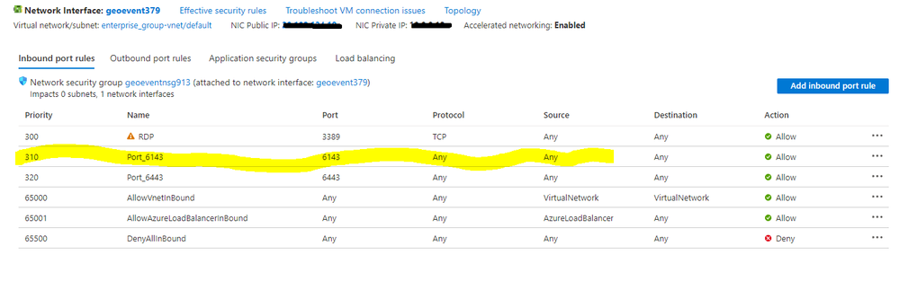

Hi Debendra, Many thanks for the quick response. My issue is different then. My setup is an Azure VM. In the Azure VM, I can get to GeoEvent Server through https://machinename:6143/geoevent/manager but get "This site can't be reached when I use https://fqdn:6143/geoevent/manager in the VM and from another machine. My understanding is for streaming services, I'll need the latter to work. The 6143 port is open in the VM. I don't what else I'm missing.
DebendraBiswas1
Hi @JiaLiu1
Apologies for getting it wrong.
Regarding accessing GeoEvent manager from outside machine using FQDN, may I ask you what do you mean by opening the port..?  Is this through window's firewall or  you have configured an inbound rule to listen on port 6143. ?
Regards
JiaLiu1
Hi Debendra, I have similar setup as in your screenshot of the Azure VM Networking for port 6143. I don't think it's Windows Firewall, as in the VM I can access GeoEvent Manager using machinename:6143 but not fqdn:6143.  Am I wrong?
