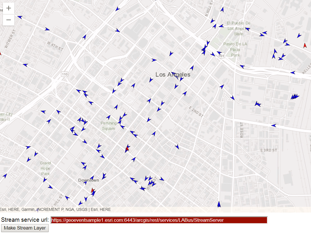

JoshPritt
We got it working last night.  Here's a snippet and a screen shot.  We can change out the "symbol" property under each UniqueValueInfos object between "blue" for the simple marker and "blueSym" for the picture marker (and red/redSym).  This is using the sandbox example page so we just put our prototype code directly in the addStreamLayer() function.  We also had to make sure to reference the 4.6 javascript API at the top. ArcGIS API for JavaScript Sandbox  You may also need to make sure to import all the correct modules at the top of the "require([" portion.  You'll also need to fix the URLs for the picture marker symbols to point to your server.
