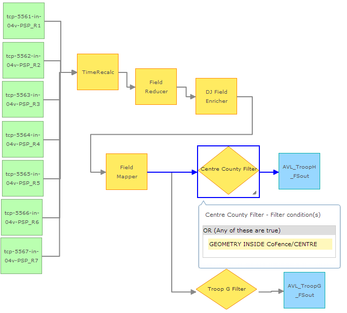

I am attempting to only show events within a specific county from a stream of events that are statewide.  I have created a service that I believe should do that:
The "Centre County Filter" as it is illustrated above does not pass any data at all.  I should mention that the CoFence geofence contains all 67 counties in our state.  When I change the filter to "CoFence/.*" it passes all events in the state, as I thought it should behave.
What might I be doing wrong to make this work incorrectly?
I should mention that I am using AGS/GEE version 10.21.
Thank you,
--Adam

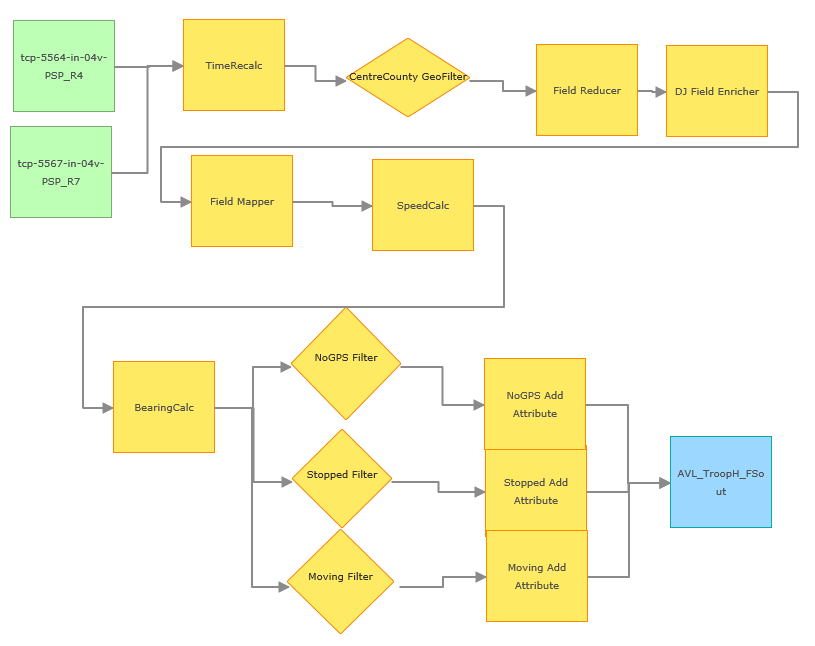

...edit to update the picture...
AdamRepsher
GeoEvent‌ Extension - Geometry filter.
Still exhibiting the same behavior.  All flow stops through the service (or model) - Delete the GeoFilter - Put another GeoFilter back in with the same parameters and it starts working again.
Any Ideas - or even a "we saw that and fixed it at 10.2.2"?
Thanks,
--Adam
