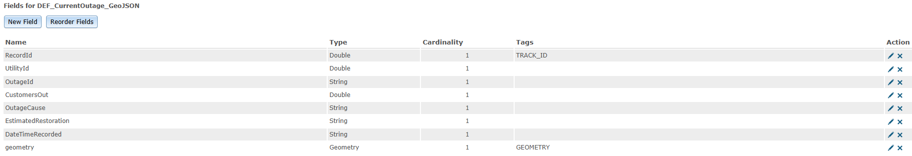

Below is the auto-generated definition.
...What am I missing here?

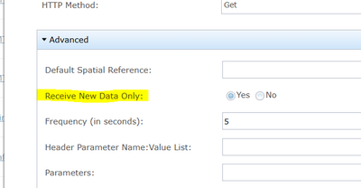

- how can I prevent duplicate rows being created after each poll?
Gene_Sipes
It may have something to do with the mixed geometries. I would try outputting to two hosted feature services, one for the points, and one for the polygons. You might have to create two event definitions, one to point to the polygon and one to point to the point feature class. Also to prevent duplicates, make sure this option is checked within the input.
