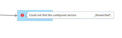

feralcatcolonist
How did this work out for you? I'm seeing the same issue EXCEPT the service is visible when accessed locally on the GeoEvent Server but does not appear on the outwardly facing end point. And receiving this error.
could not find the configured service "..."
