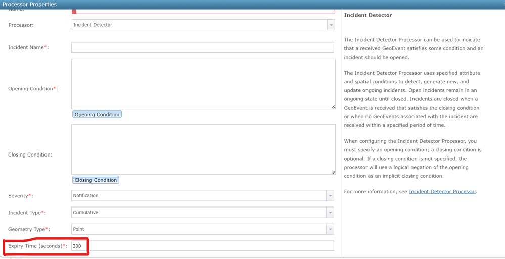

I need a help in this processor I need to assign a dynamic value to Expiry time parameter.
Also I need to know is there a way to download the source code of this processor and I cand edit it using SDK ?

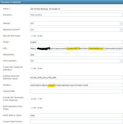

You can use {value} for dynamic parameter (see image below)

Thanks Dominic for your response,
The expiry time value in the incident detector processor doesn't accept dynamic value as attached photo.
 Regarding to the sample Yes I tried it previously but I was wondering if it's available to get the source code or .jar file of the available ready to use processors instead of writing it's code from scratch.

The image is not of a great quality but I believe you have a typo:
seems like you have
[company_something}
and it should be
{company_something}
