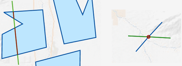

Illustrated below are a couple of the use cases I've used to verify the enhancements to the Intersector processor at 10.5
You'll notice that you can still obtain a multipart polyline when an event's polyline intersects a polygon GeoFence at two separate line segments. You can also get the point intersection between two polylines.
