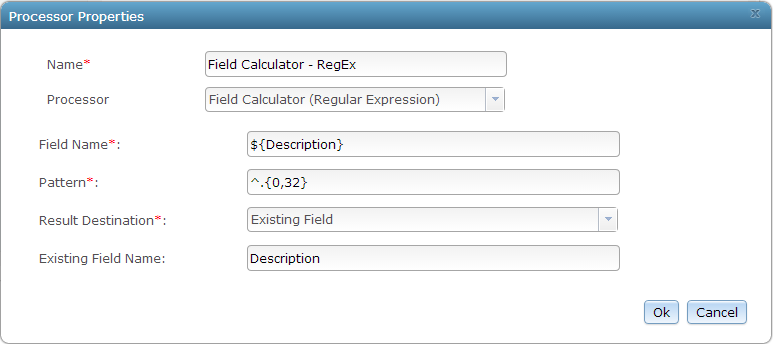

The simpler approach is discussed in the Introduction to GeoEvent Server tutorial, Module 4 pages 10-12. The Field Calculator (Regular Expression) processor can be configured with a regular expression which applies a quantifier (or match count) to a portion of a pattern. The example illustrated below anchors the pattern match to the beginning of the string in the Description attribute and matches zero-up-to-thirty-two single characters. The matching sub-string is then written back into Description effectively trimming the string's length.
