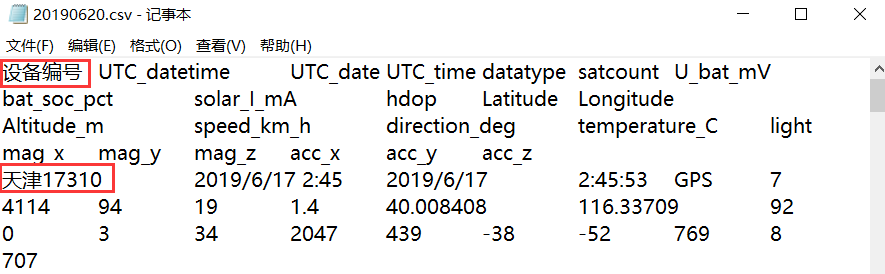

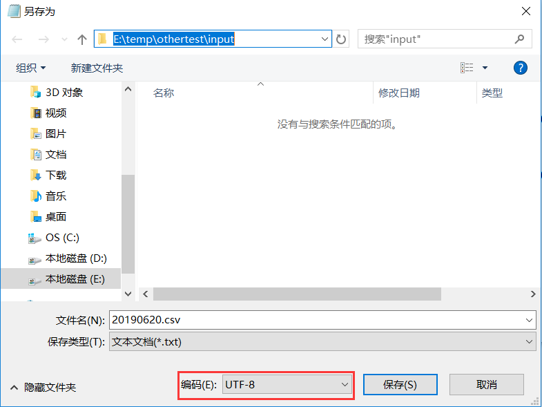

I  use  "wath a folder for a new csv/json file " input connector to ingest the real time data , and find that it works well in files that do not contain chinese characters,  if I change some field names or field value to chinese characters in the same file and it does't work, even though I have changed the file's encoding to "UTF-8". so I want to know that does these input connector support UTF-8?

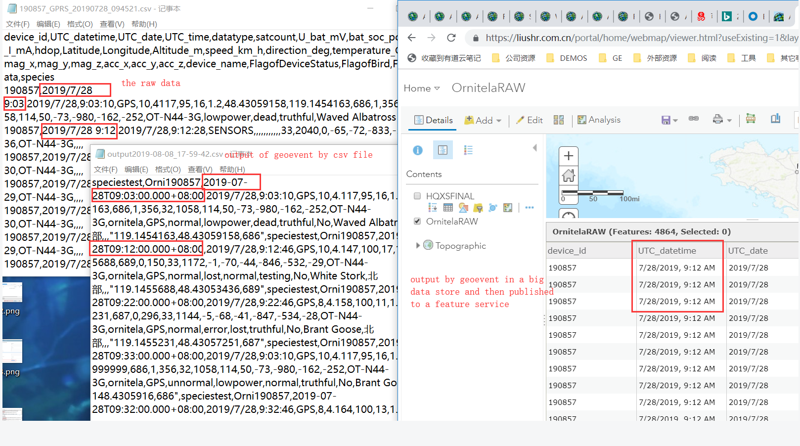

and another question about this connector is that , the parameter of Expected Date Format  will convert the data time to what format? I format it like this"yyyy/MM/dd hh:mm:ss" and the input datetime is "2019/7/28 9:12" and the output datetime format become to "2019-07-28T09:12:00.000+08:00"(write to a csv file output), it is seems that it change the datetime to "UTC+8"? and then it looks like this "7/28/2019, 09:12 AM" in portal viewer througt the attribute table ,which the feature layer is published by geoevent with "add a feature to a spatiotemporal big data store" output connector.
I am a little confused about these datetime, does they mean the same time? is there any methord to keep the three of them in the same way to expressing the datetime?

we are also struggeling with the encoding. We also have text files that contains special characters. The first hint I got was to set the "Is the file text" Parameter of the Input connector to false.
The file transport has a 'Is File Text' parameter which when set 'True' (the default) limits data to single-byte character sets (typically the ASCII character set 0x0020 - 0x007e). The error is misleading as the file's data *is* UTF-8 encoded. Multibyte character sets can be UTF-8 encoded, but GeoEvent's FILE transport only accepts single-byte character sets. The request is to enhance the FILE transport to work with multi-byte character sets (and correct the error message suggesting the problem is with UTF-8 encoding).

For your last question, on how an input's Expected Date Format parameter works and what a "date" will be converted to – I would say that when a GeoEvent Definition specifies that a field is a Date an inbound adapter will attempt to use the pattern in the Expected Date Format parameter to interpret a string to create a Date. In this context a Date is a Java primitive type like LongString, or Double.
You might want to take a look at a blog I published https://community.esri.com/community/gis/enterprise-gis/geoevent/blog/2019/03/14/what-time-is-it-wel...
A date can be represented several different ways.
  • As a verbose string ... "Thursday, August 22, 2019 3:30:00 AM (GMT)"
  • As an ISO 8601 value ... "2019-08-22T20:30:00-07:00"
  • As a long integer in epoch milliseconds ... 1566444600000
All three representations above are the exact same date/time. When using a 'Write to a CSV File' output the default is to represent the time as an ISO 8601 formatted string. The +/- 0:00 at the end of the string tells you how many hours the value has been offset from UTC. When adding or updating feature records in a geodatabase like the spatiotemporal big data store Date values are stored as epoch long integer values in milliseconds.
When you click a feature in a web map it is up to the client how to represent the date value. You should be aware that when an Expected Date Format pattern is specified it is likely that the date value will be considered a local date/time value. This also likely means that a web application, when it queries the date value from the geodatabase, will assume that it is receiving a UTC value and offset the value for you to a local date/time and represent it as a string. I mention this so that you will look for the possibility that a date you read from an input file is not representing as the expected date value once it is (a) written out to a feature record and (b) queried by a client and converted to a string for display in a pop-up dialog.
