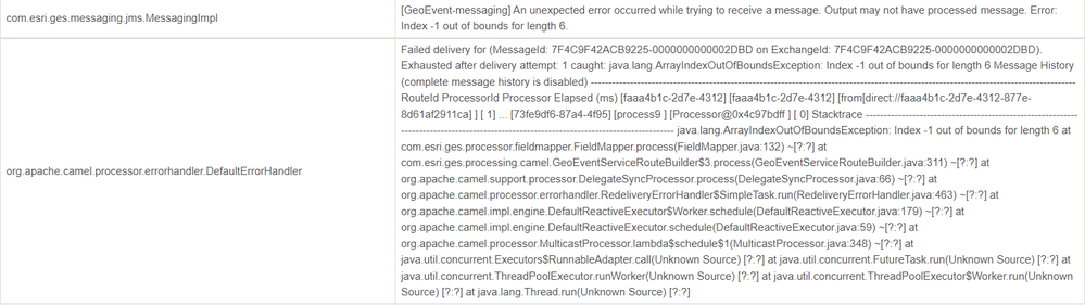

I could add that the following are the error messages I get when trying to solve the issue by using the Field Mapper processor: geoEventError.png
