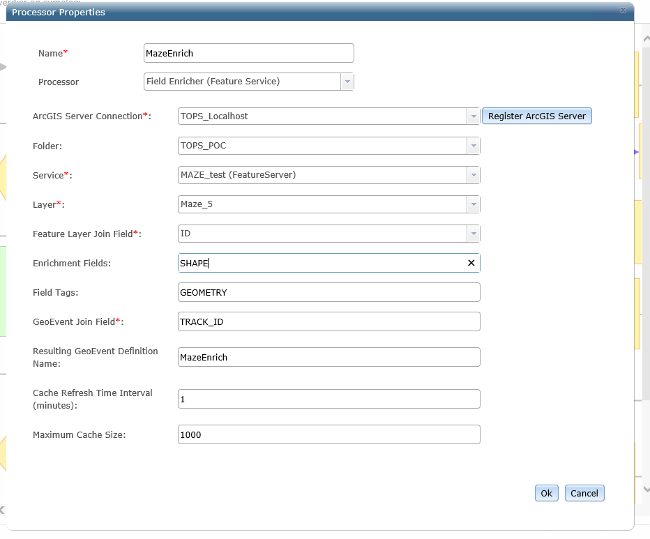

ColleenFarrell
I have this same situation and I was able to get it to work.  Alarms from our smart meters do not have coordinates.  I was able to use the Field Enricher (Feature Service) to query an existing meter featureclass, get the geometry, and write out a smart meter event.  I attached an image of my example.
