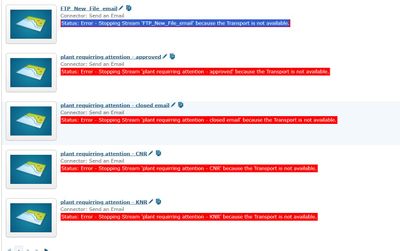

najeebhall
Hi @EricIronside ,
I am facing the same issue, will doing your fist suggestion delete any on the inputs/outputs or configurations i have setup on the geoevent manager?
EricIronside
Hey @najeebhall
Deleting the contents of the <GeoEventInstall>/Data/ folder will not impact your configuration and will not delete any inputs, outputs or service configurations.  The contents of the /Data/ folder act as a local cache where GeoEvent stores temporary files. Deleting this folder will force GeoEvent to reload its underlying components (uncompress, create temporary files, etc.).
