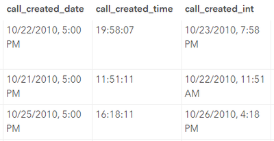

Hi @RJSunderman , thank you so much for the reply. However, I think I am still in need of some assistance here. Allow me to explain my issue further.
My CSVs have multiple date and time fields. Some of them have Epoch Values which I was able to convert to desired MM/DD/YYYY MM:HH format, thanks to your earlier post.
However, I also have some fields with 'Date' data type (not string) that have date values in them. Since my end users/client application require fields that have 'date' values only, I am trying to retain the original date only format.
In the following screenshot, W is a 'date' field, X is a 'time' field and Y is a 'date' field with epoch values (the CSV was exported from SQL Server). I was able to convert X and Y respectively as 'string' and 'date' field (in geoevent definition). However, I want to import W column as date in feature service (with no time values). Is it possible in Geoevent/Portal? Or does Geoevent/feature service cannot handle date only fields?
P.S - Following is a screenshot of a feature layer created using above CSV (different records, values do not correspond to CSV above). As you can see, 'call_created_date' field has unwanted and default 5 pm values appended to it.
Thanks again for your time,
Shital
EricIronside
hey @Ctal_GISsquad
The default time that geoevent creates is going to be UTC.  So if your server's time is not set to UTC, the date will be offset according to the timezone you are in.  To get around you can add/subtract your timezone offset from the date value. But that only returns the time assigned to the date back to midnight (or noon) and doesn't really get rid of it.  To not display the time, you will need to rely on the web map to format the date field without a time.  Alternatively, you could add the time you have from the call_created_time field (call_created_date - timeZoneOffset + call_created_time). This would result in a date in call_created_date field that had the proper date and time. That assumes the call_created_time is a local time (if it is in UTC you can omit the timeZoneOffset).
