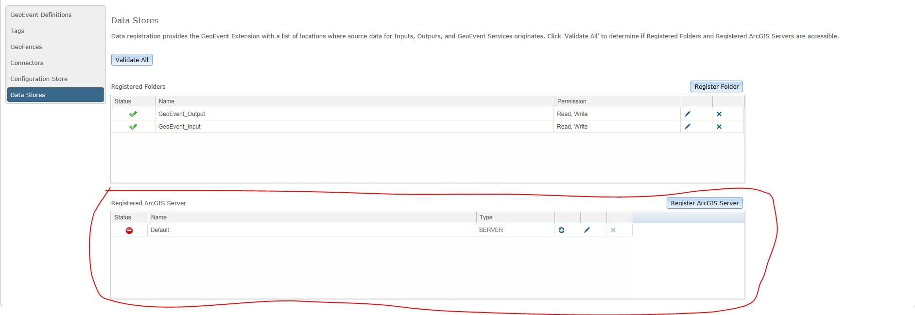

I am currently experiencing an issue with Registering an ArcGIS Server with GeoEvent Manager in the "Data Stores" menu. Whenever I attempt to register an ArcGIS server, a red icon appears in the status field (See Image Below).

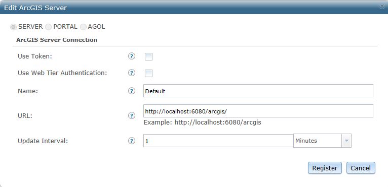

For reference, Below are the values that I have populated for the "Edit ArcGIS Server" window.
Does anyone know why the ArcGIS Server cannot be registered with GeoEvent Server? Please let me know if I can provide any details that might help.

I figured it out. I needed to use token based authentication (see number 1 in the image). I first generated a token on the server that I wanted to register.  Next, I entered the token that was generated from the server (see number 2 in the image). After that, the server was successfully registered. I appreciate your help!  crodriguezesri-co-esridist‌.

Unfortunately, I was not able to register the server after entering my server information in the format that was specified above. The "My Server" item below is what I wanted to register. What else do I need to do?

What kind of message show when you are on status logo? Do you need check the credentials provided?

I am getting a "Token Required" message when I hover over the red error icon that you hovered over.
