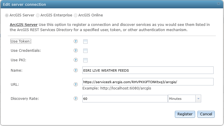

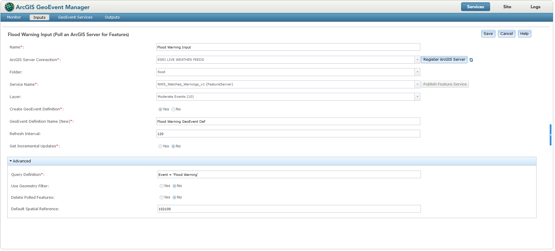

1.  I will set up my Input to poll a service from a Live Weather feed.  There are a lot of free Live Weather feeds you can access as mentioned here.  I configured a Data Store in GeoEvent to connect to the following URL:  https://services9.arcgis.com/RHVPKKiFTONKtxq3/arcgis
2.  I created an Input to Poll an ArcGIS Server for Features from this Live Weather Feed every 2 minutes.  I set a query to only return Flood Warnings.

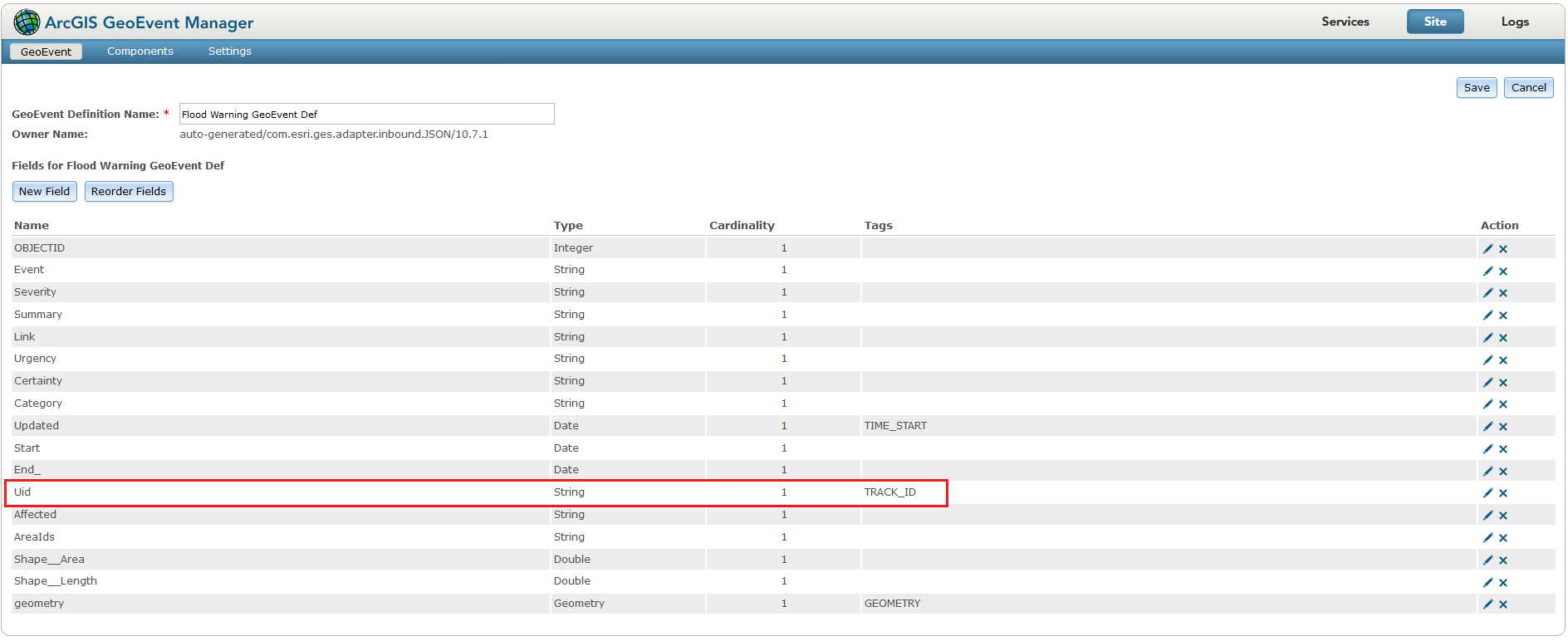

3.  When configuring the Input I chose to create a GeoEvent Definition called Flood Warning GeoEvent Def.  I will next tag the Uid field as the TRACK_ID:

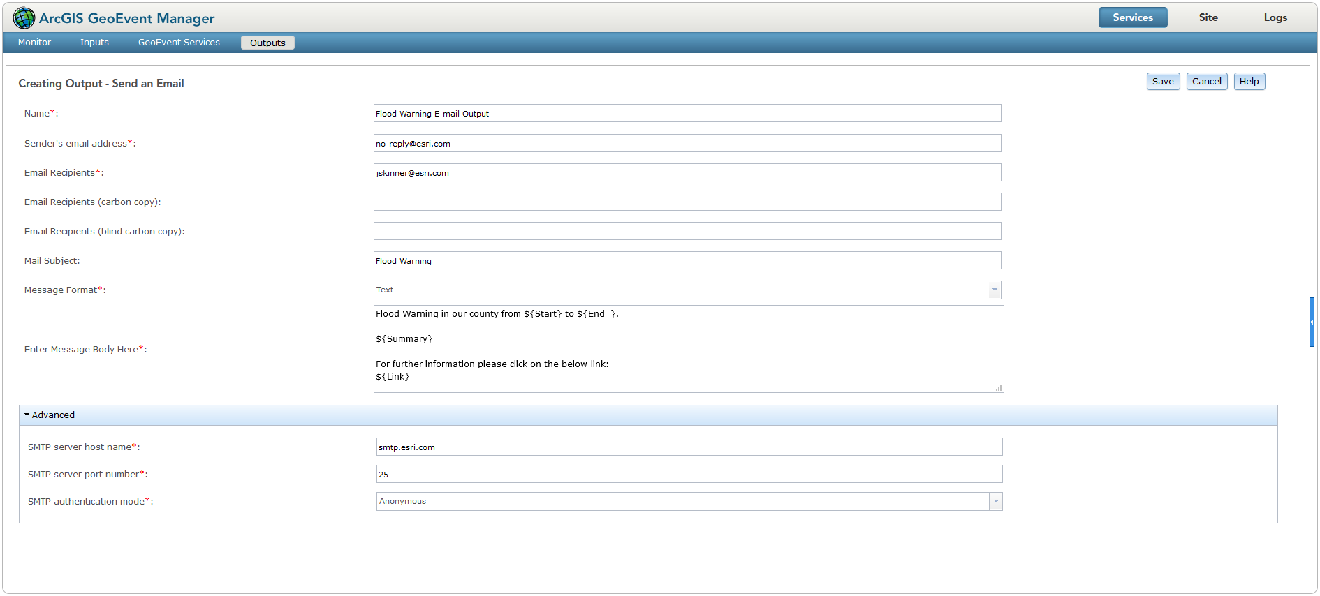

4.  Next I will set up a Send an Email output.
I'm calling fields from the service I am polling by using the sytnax ${fieldname}.  For example, I'm calling the following fields:
  • ${Start}
  • ${End_}
  • ${Summary}
  • ${Link}

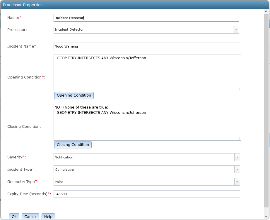

5.  I have an Input and an Output, so now I will need the link the two by creating a GeoEvent Service.  The first Processor I will add to this is the Incident Detector:
Note:  GeoEvents sent into Incident Detector must have a GeoEvent Definition containing a TRACK_ID.
  • Incident Name:  can be set to anything
  • Opening Condition:  in this example the opening condition is set to create an incident if the incoming geometry intersects a particular geofence (Jefferson County in Wisconsin)
  • Closing Conditionthe incident will be ended once the closing condition is met.  The closing condition is when the incoming geometry no longer intersects the geofence
  • Severity:  set to either Notification, Warning, or Urgent
  • Incident Type:
    • Point-In-Time incidents have no closing condition. They are considered instantaneous and are closed immediately after they are generated and have no incident duration.
    • Cumulative incidents have both an opening and a closing condition. The time between the incident's generation and its expiry, or closing, is the incident's duration. Cumulative incidents are monitored and updated by GeoEvent Server as additional event data is received.  This is required in this example.
  • Geometry Type:  Incident Detector is typically configured to associate a point geometry with incidents it creates to model an incident as having occurred at a specific location at a specific time. However, multipoint and polyline are also supported geometry types for incidents created by the processor.
  • Expiry Time:  when the expiry time is met, the incident is closed/ended, even if the closing condition is not met.  In the above example I set this to a large value (4 days) so that the incident is not closed.  If this was set to 5 minutes, another e-mail notification would be sent after 5 minutes even though the closing condition was not met

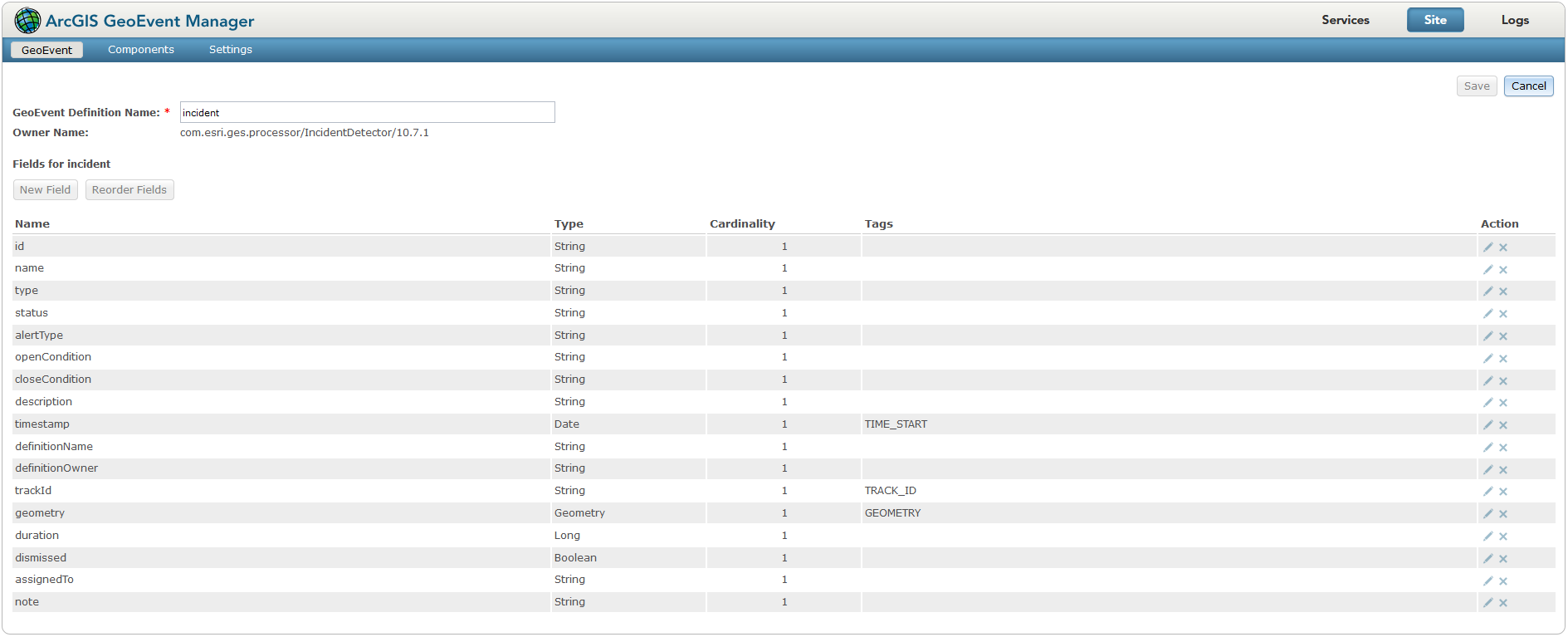

6.  When the initial opening condition is met, the event switches from it's incoming GeoEvent Definition (i.e. Flood Warning GeoEvent Def) to the incident GeoEvent Definition:
The only information retained from the initial GeoEvent Definition is the field tagged with TRACK_ID.  Since the event is now using the incident GeoEvent Definition, status is a field that will be populated with the value Started when the opening condition is first met.  When the event is received again, the status will be Ongoing.  When the closing condition, or the expiry time is exceeded, the status will be Ended.

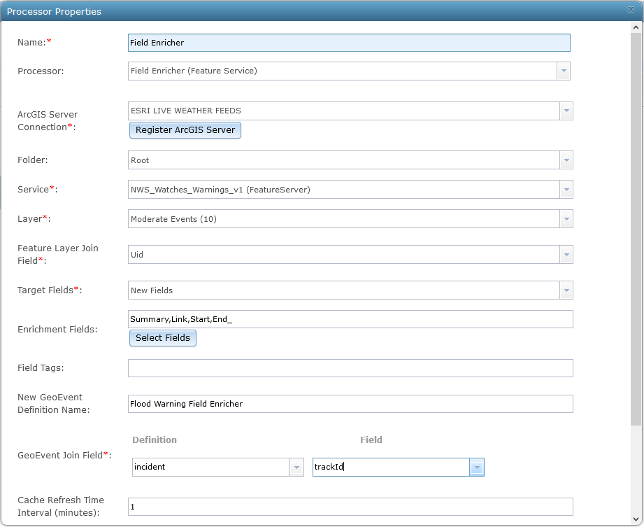

8.  I configured the e-mail output to use fields from the Input Flood Warning feed.  Since the event is now using the incident GeoEvent Definition I will have to join the information back from the initial GeoEvent Definition to retrieve these attributes.  To do this I will add a Field Enricher (Feature Service) processor:
  • ArcGIS Server Connection:  the connection where the Input is coming from
  • Folder:  the folder the service resides in
  • Service:  the Flood Warning service
  • Layer:  the layer we're polling
  • Feature Layer Join Field:  this will be the field tagged as the TRACK_ID in the Flood Warning GeoEvent Def
  • Target Fields:  I will be joining New Fields as they do not exist in the incident GeoEvent Definition
  • Enrichment Fields:  which fields I want to join (these are the fields I used in the e-mail output)
  • New GeoEvent Definition Name:  a new GeoEvent Definition is created when creating New Fields
  • GeoEvent Join Field:  this will be the incident GeoEvent Definition and will use the trackId field as this field contains the information from the field tagged with TRACK_ID (in this example I tagged the Uid field)

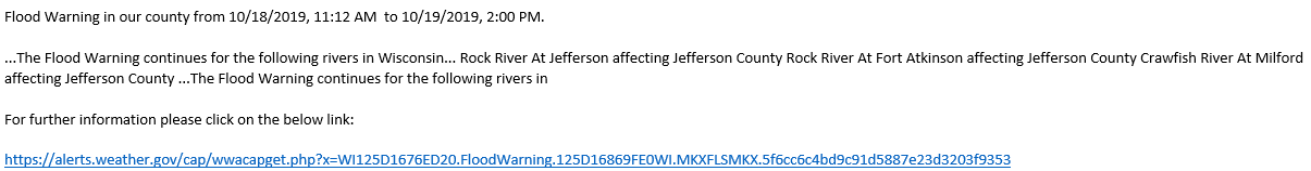

When a Flood Warning event intersect Jefferson County, it will send one e-mail notification with details associated with that Flood Warning.  Ex:
