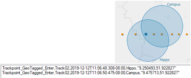

The filter is masking event records the GeoTagger needs in order to correctly determine Enter / Exit. Each node maintains its own cache of observed events (one reason stateful operations like “enter” and “exit” are problematic). The filter “ENTER” determines an event is outside the AOI (so ENTER == FALSE) and the event is discarded. We don’t care that the filter discarded the event in this case because nothing interesting happened (we’re not entering an AOI). But when the next event intersects the AOI and its previous track point was just outside, the filter “ENTER” determines ENTER == TRUE and passes just the one event along.
What we have to understand is that the “Tag on Enter” GeoTagger, at this point, has never seen an event record with this track identifier. The “First Event Triggers Enter” property (a Global Settings property) allows the GeoTagger to evaluate ENTER == TRUE. So we get the tagged event we expect. The same exact evaluation is performed when the event record enters the overlapping area for the first time:

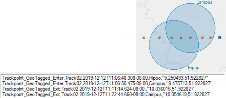

The weirdness starts when the track point is first observed exiting the geofence “Hippo”. The GeoTagger output has a null value in the geofence’s name, even though the Filter determined that an exit has occurred. Why? Because the “Tag on Exit” GeoTagger never saw an event record inside “Hippo” and the global setting “First Event Triggers Exit” default to False.
The EXIT filter saw the previous event, inside, and was therefore able to determine EXIT = TRUE … but all the previous events which were not “exiting” were discarded by the filter so the GeoTagger never saw them. The GeoTagger therefore evaluates EXIT == FALSE and places a null value into the event record’s field as the name of any geofence the event has found to have exited.
When the event moves outside “Campus” the “Tag on Exit” GeoTagger has seen an event record inside “Campus” … when it was just exiting “Hippo” … so it is happy enough to evaluate EXIT == TRUE and enrich the event with the name of the geofence the event record was last observed inside and is now outside.

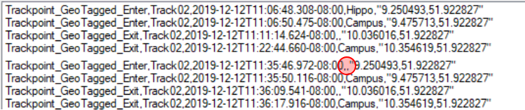

The real weirdness starts when you run the same eight track points through the GeoEvent Service. This time the “Enter” branch at the top seems able to determine that the event is entering something but cannot name the geofence being entered.
This is again explained if we recognize that we have not done anything that would clear either the ENTER Filter’s cache or the “Tag on Enter” GeoTagger’s cache (like republishing the GeoEvent Service). The “Tag on Enter” GeoTagger has exactly two observations; event record locations inside “Hippo” and inside both “Hippo” and “Campus” when the event records entered those areas for the first time during the last iteration. All of the other received event records were discarded when the ENTER filter determined “not entering”.
So as far as the “Tag on Enter” GeoTagger is concerned, the event is still inside the area “Hippo” when the second report for the second iteration is received. The GeoTagger determines ENTER == FALSE because it has seen records with this track identifier before, so the “First Event Triggers Enter” property does not apply.
Focusing, then, on the last two outputs for the second iteration … analytics for exiting are on a completely separate branch of the GeoEvent Service. That last time the “Tag on Exit” GeoTagger saw a track point from this stream was when it had just exited both geofences and was disjoint all geofences. So when it gets the next “exiting” event (the 6th in the series of eight) it determine EXIT == FALSE because it has not observed the event inside at any point between its last observation and this observation. Therefore the second-to-last message output (again) has a null for the geofence name. But when the event finally exits the two geofences for the last time the “Tag on Exit” GeoTagger has seen the event inside “Campus” so it’s at least able to tag that geofence’s name into the exiting event record.

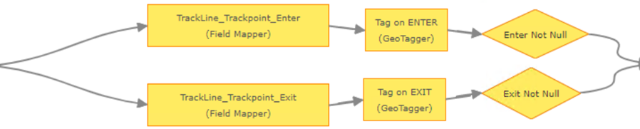

GeoTagger-Filter Pattern
To fix this, you need to reverse the order of the GeoTagger and filter.
The GeoTagger will capture the name of the yard that was entered/exited (and a null value if the truck is not entering/exiting a yard). The filter will remove any events that have null enter/exit information. Computationally, this pattern has the same number of initial spatial operations (to perform the enters/exits operation), but substitutes the second spatial operation for a simple null attribute check.
