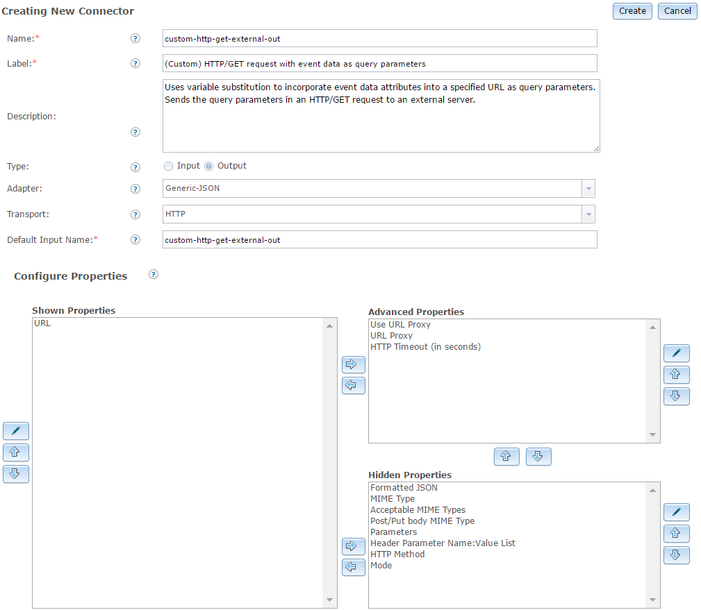

  1. Configure the following GeoEvent Server output connector.
    Browse to Site > GeoEvent > Connectors and select to create a new outbound connector. Default values for the "Shown", "Advanced", and "Hidden" properties are included beneath the illustration.

  2. Save your newly configured custom outbound connector.

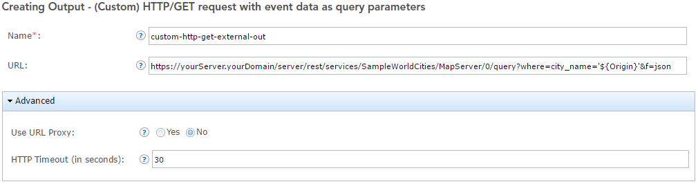

  3. Navigate to Services > Outputs and select to create a new (Custom) HTTP/GET request with event data as query parameters output. Configure the output as illustrated below, replacing yourServer and yourDomain with a valid server and domain for your organization.
    Note the URL specified in the illustration:
    https ://yourServer.yourDomain/server/rest/services/SampleWorldCities/MapServer/0/query?where=city_name='${Origin}'&f=json
    The format of the URL assumes that an ArcGIS web adapter (named 'server') has been configured and that an external server or client application receiving this URL could use it to query the "Sample World Cities" map service on your ArcGIS Server. GeoEvent Server will substitute the variable ${Origin} in the URL's query parameter with an actual attribute value from a received event record, enabling the external server or client application to make a more specific query based on real-time events.
  4. Save your updated output, then publish a GeoEvent Service which incorporates your output and an input of your choice. You can use any type of input, so long as the GeoEvent Definition associated with event records received by the input includes an attribute field named Origin.
