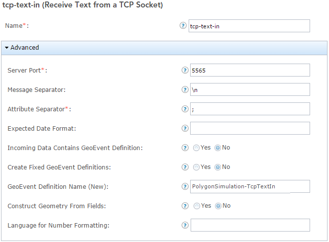

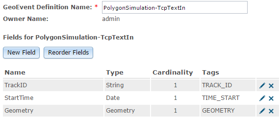

Attached are illustrations of the GeoEvent Definition I configured my 'Receive Text from a TCP Socket' input to use. The input is still responsible for adapting the delimited text it receives from the GeoEvent Simulator, so it needs to know what characters to expect for the message separator and attribute separator ... and it relies on an event definition to tell it that the third attribute should be interpreted as a Geometry.
